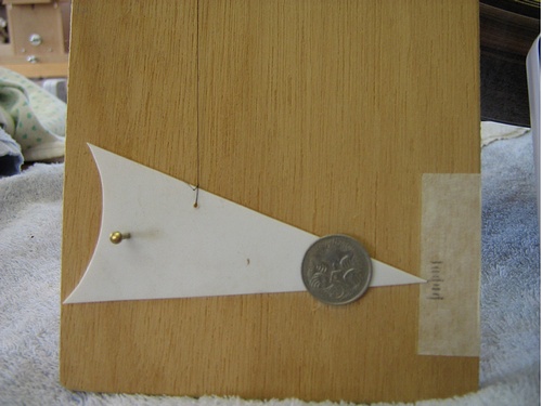

The simple device Carleen had was a strip cut off a sheet of plywood. One of the three plys was milled off, leaving a cross grain strip glued to a long grain strip. This was screwed to a block which was then mounted on the wall with the strip, iirc, horizontal. The cross grain side would expand and contract much more than the long grain side with changes in humidity. This would cuase the strip to bend up or down, and it was a simple matter to mark where the end was on the wall when the weather report gave a humidity reading. The arc or marks on the wall was pretty wide. I would not call this 'lab grade' or anything, but it was sure accurate enough for lutherie. It's been a while since I read Romanillos' book, but it seems to me what he described was similar.

I knocked this up a couple of years ago using 3 strands of my daughters hair . Same as Ron's horse hair one I guess
It lives next to my digital hygrometer and is just as accurate .
The strands of hair are about 9 inches long. Apparently this is all scientists used a hundred years ago. As to how long they have been around , I have no idea.
Cheers Craig
